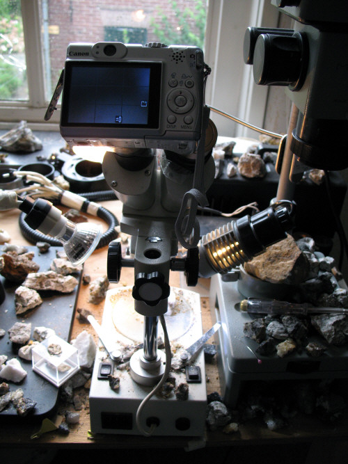

Here are some tips for those of you that would like to venture out into the wonderfull world of mineral micro photography.
Here's what you need:
1-a microscope, doesn't have to be an expensive one, either a binocular or a trinocular.
2-a digital camera with an optical zoom (very important, only digital zoom won't do!!), the same goes for this, it does not have to be an expensive one (it shouldn't be too heavy though), and in case you use the phototube of a trinocular you also need an adapter to fit the camera to the microscope.
3-a lightsource, the best option is a "cold light" (i.e. optical fibre) source, because in that case there is no excessive heat building up close to the specimen or your microscope (if you think such an installation would be too expensive it's also possible with ordinary spots, take care though with the heat!)
4-a software kit for editing photo's, these come usually with a new camera, for instance, with my Nikon came Photoshop and with my Canon cam- Photo-edit deluxe.
This is what you do:
1-You place the specimen under the microscope and look for the crystal or area you would like to photograph.
Look only through one occular, this wil be the ocular trough which you'll make the photograph when working with a binocular.
When working with a trinocular it would be good to attach a notebook or a TV screen to the camera to be able to judge the right frame.
Take great care in positioning the object at an easteticaly appealing angle (a crystal photo from a 90 degree angle on it's top is hardly ever appealing).
Just tilt the object until you have a nice angle and turn it around until you capture it's most favourable side.
Keep in mind, a low horizon (in this case the matrix on which the crystal rests) makes the crystal look far more impressive!
Also take great care in the composition of the image, make sure that there is an equal balance between the crystals in the image, one corner shouldn't be heavier as the other ones, and if it is (if that's your decision) move the specimen around until you have a "counterweight" somewhere else in the image (you can edit the composition with your software, more on this later).
Now make sure your specimen is properly lit.
For me the most beautifull results are achieved when you have an overall moderate lightsource and a strong lightsource from one direction (left or right, whatever makes the crystal look the most brilliant.
I usually take my pics in front of the window with daylight and boost this using a fibre light (cold light installation) from either the left or right side.
If you're ready with this you can move on to the next step.
2-Take out your camera and place the objective on the ocular through which you were looking when you were positioning the specimen, when working with a trinocular the camera is already attached to the phototube.
Then zoom in using the optical zoom until the rounded edges of the ocular or phototube dissapear, or further until you have the image you like (this will show on the little screen on the camera, important not to turn this off, this is where you should look from now on, looking directly through the camera won't work, or of course on the TV screen or notebook).
Switch off the flash.
Put the dial of your camera on the "manual" position and the macro position.
If you use an extra lightsource besides daylight you should switch the white balance of the camera to "incandescent" light.
If the backgroud of the image you've chosen is very light compared to the crystal make shure you switch the exposure (exp. +/-) a few stops up (+), if the crystal is very shiny you can counter this by putting it a few stops down (-) or take back on the lightstrength (not too dark though!).
Now hold the camera in place on the ocular (this of course doesn’t apply to working with a trinocular scope) with your left hand and turn the adjusting/sharpening knob of your microscope with your right hand whilst looking on your camera screen, turn it until the image on the camera appears as sharp as it can get.
Then hold your camera very still or make sure the camera is properly attached to the phototube and press the button to make your photo.
Try this a couple of times until you get a satisfactory sharp image and then go on to experiment with your lighting, camera settings and positioning of the specimen.
If you experiment a lot you'll quickly see your images improving dramatically, experience is the key here, as so often.....
When you have a couple of shots on your camera you can go on to the next step.
3-Edit the photograph using the software provided with your camera.
The manual will tell you what to do in order to be able to use the software the most effectively, ofcourse I can't go into that any further here because there's so much different programmature around, I can say though that I'm very happy with Adobe photoshop augmented with Photo-edit.
Now on to the final step.
If you don't have any editing software you can skip this step and go on to the next step.
4-Save the pics on your computer (I allways choose the jpeg format because its acceptance is so widespread) in your documents and if you like print them on photopaper.
If this is all consumed well and everything works fine you can go on to making multilayer images and stack these using the software from Helicon or CombineZ (free!!), you'll be surprised what you can do with that, but that's for later, first get to know the basics well.
I'll post something on stacking here on a later date.
A link to stacking: www.strahlen.org/forum/viewtopic.php?t=56
Well, that's about it.
I hope I've been able to show to you that you don't need a lot of fancy expensive equipment in order to make basic mineral photograph through the microscope.

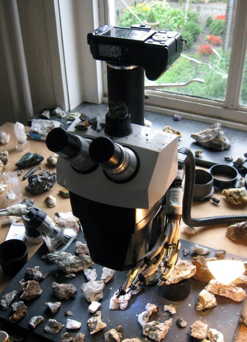

Finally a short line on what gear I use:
For the basic method I use a Canon A540 combined with a cheap standard Byomic scope (with very good natural light coming through), this still works the best for moderate magnifications.
For higher magnifications I use a Canon A640 combined with a Bausch&Lomb StereoZoom7 with phototube.

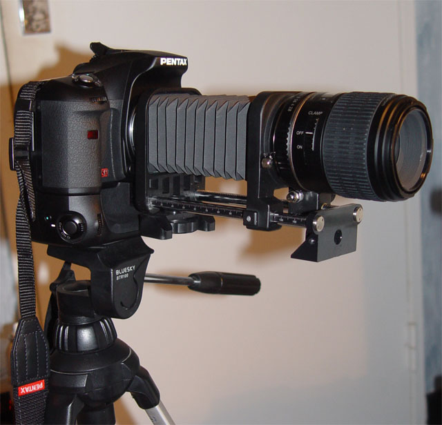

moins à 5:1 (c'est mieux que les bagues allonges, mais ça ne transmet pas les automatismes (donc plus d'AF)), le souci c'est que pour boîtier Pentax, il a fallu que je le fasse importer mon matos de.... Chine !!!!!!

Tu sembles dépité de ne plus pouvoir utiliser l'auto focus ? Il me semblait que celui-ci devait etre débrayé pour faire de la micro ?
Tu as achete ton materiel en Chine ? pour le Pentax ? S'agit' il du soufflet ? on en trouve pas en France ? Eventuellement je suis interressé par des précisions car c'est une voie que je compte aussi explorer !
J'ai un ancien tube macro Tamron de 90 mm que je mettais sur un Pentax de base argentique P30N ! Je pense que si j'achete le K10 ou le K100 de Pentax il semble que je puisse le réutiliser !
Cet objectif avait la réputation de ne retirer que tres peu de lumiere lors des agrandissements ! J'ai pu verifier cela mais à l'epoque j'avais que de la lumiere de type spot ! Ce qui donnait de la couleur jaune aux photos malgre un filtre adéquat !
A +
Serge
Invité Rémi BORNET
:grand sourire:
L'avantage de l'autofocus c'est une netteté irréprochable, j'ai des lunettes et quand on fait la mise au point très précisément sur quelquechose de très petit à l'aide du viseur, à la sortie ce n'est pas forcément la zone qui nous intéressait qui ressort nette... lol
L'appareil, pas de souci pour le trouver dans le commerce, il est en vente dans les boutiques spécialisés (j'ai acheté le mien à la Fnac), par contre l'objectif 100mm macro, j'ai du chercher sur le web pour voir qui l'avait en stock... Les souflets pour pentax on en trouve pas en France, déjà que quand c'est du Nikon ou Canon, ce n'est pas évident à avoir... du coup j'ai fait importé le mien de Chine 50€ environ.
Ton tamron de 90mm c'est du M42 ou bien une baïonette ? Parce que les adaptateurs M42, il faut prendre du Pentax et c'est assez long à avoir...
C'est un peu le souci de Pentax, les objos et les accessoires sont long à avoir et chers... surtout en France... Ex : Le Sigma 50-500mm EX est à 1479€ chez Camara, aux USA il n'est qu'à 750€... Dans tout les cas il faut le commander car personne ne l'a en stock pour Pentax, alors devinez où les gens se servent...

Ici c'est un trino Bausch&Lomb StereoZoom7 avec un Canon A640 (10 Mp) sur la phototube.
Est-ce que ce système fait de bonnes photos ? J'ai une opportunité de récupérer une trino de labo pour pas très cher avec ce 3ème tube. En fixant un reflex 10MP dessus je pense que cela ne doit pas être mal, j'ai vu qu'il existait des adaptateur pour diamètre de 25mm en monture K (pour mon Pentax). Si je rachète cette trino et bien de me débarrasserait de mon actuelle bino, alors si il y a des amateurs... ils peuvent me contacter par MP :super:
Hi Remi,
En Anglais, j'espere que c'est ne pas un probleme......
The combination works quite well, the only problem is that the length of the phototube implies a lot of loss of light and vigneting is a problem as wel.
For me the best solution to date is still to use a compact camera with a narrow lense and lots of optical zoom (digital zoom will cause a dramatic loss of resolution) to counter vigneting.
A very important issue is the choice of the objective for your microscope, for photography a Plan (PlanApo for instance) objective is by far the best solution, it will cost you a buck or two though.....
In this months Lapis issue there is a good article by our Strahlen member Volker Betz, it shows a lot of different set-ups, really worth reading (in Deutsch....)
